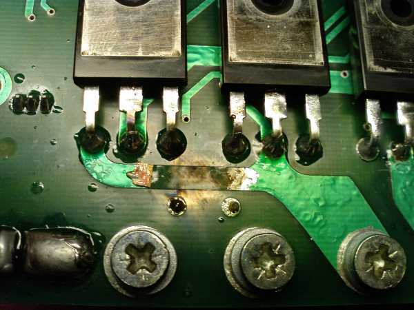

Så här gick det med min mammut drive därifrån :?
På 72vdc inga problem
På 130vcd en minut senare = trasig
Här är svaret från CNCdrive.com
Hi Christer,
We get some feedback last week with the same problem.
The broken was caused by too weeks lines of PCBs, we requested 100um of PCB
thickness tracks and the PCB manufacturer made them with much thinner and
track cannot handle current above around 15 Amps and it burn down. :(
The other thing is we requested with ROHS and they sent them non-ROHS. We
switched PCB manufacturer immadiately, but they made us a big problem,
because a whole series of drives where sent out errorous. :(
We did not notice this problem, when PCBs arrived to us, only checked and
see what's the problem last week, when the first problem (same as at you)
occurs at one of our customer.
So, we will replace your drive this week, I will send you a new drive, and
really sorry for the problem.
I will send you tracking number of the new package in 1-2 days.
You may repair that drive just solder a direct-wire, make a bridge above the
wire and then you may use the damaged drive also till you get the new one,
if it's important to make it work till the new drive arrives.
Regards,
Balazs
Får en ny drive så det blir bra :P
