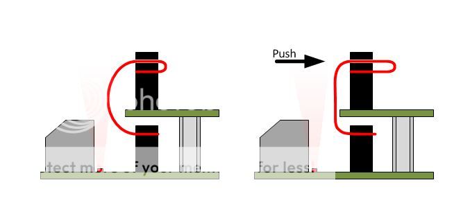

From the picture of MB2 with ESS. I think you can improve LED and Labels visibility by pushing exceeded cable back to another side of connector clamp as shown in the illustration picture.
Sorry, I didn't mention this in the MB2 manual.
